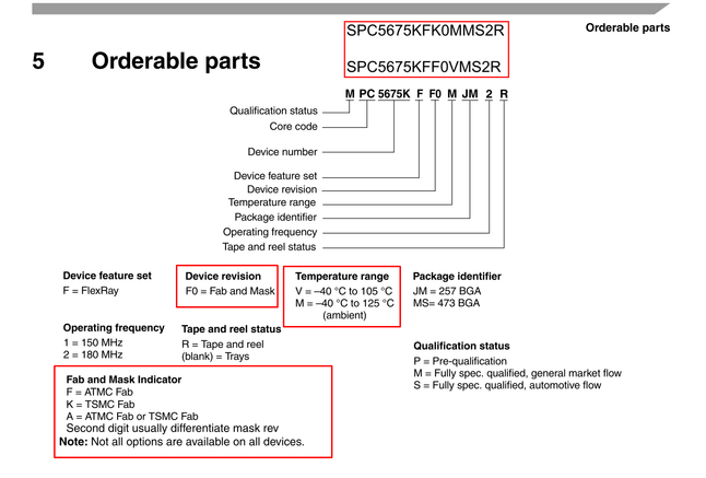

老产品SPC5675KFF0VMS2R已经停产,官网提供的信替代型号SPC5675KFK0MMS2R与原产品的具体区别,还求提供说明,谢谢

The old SPC5675KFF0VMS2R has been discontinued. I'd appreciate a detailed explanation of the differences between the replacement model SPC5675KFK0MMS2R and the original model, as provided on the official website. Thank you.
I'd like to know the differences in parameters between the new SPC5675KFK0MMS2R and the original SPC5675KFF0VMS2R.
Here are the differences:
K0 vs F0 - different factory but same device cut (revision)
M vs V - different temperature range
You can find these information in datasheet rev 9.
