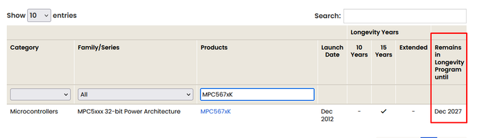

已停产产品SPC5675KFF0VMS2R,是否有官方推荐的完全替代新型号?同时求其完全替代型号的参数与原型号的参数差异,非常感谢!
304 Views
petervlna
Is there an official replacement model for the discontinued SPC5675KFF0VMS2R? I'd also like to know the differences in parameters between the replacement model and the original model. Thank you very much!
It depends if you are looking for replacement for new project or for existing product.
Because the SPC5675K is still in production (but I would not recommend it for new design)
https://www.nxp.com/part/SPC5675KFF0VMM2#/
For automotive application you can have a look at S32K3 family which replaces the MPC5xxx family
https://www.nxp.com/products/S32K3
for RADAR projects you can use one of S32R devices:
https://www.nxp.com/products/processors-and-microcontrollers/s32-automotive-platform/s32r-radar-proc...
Peter
