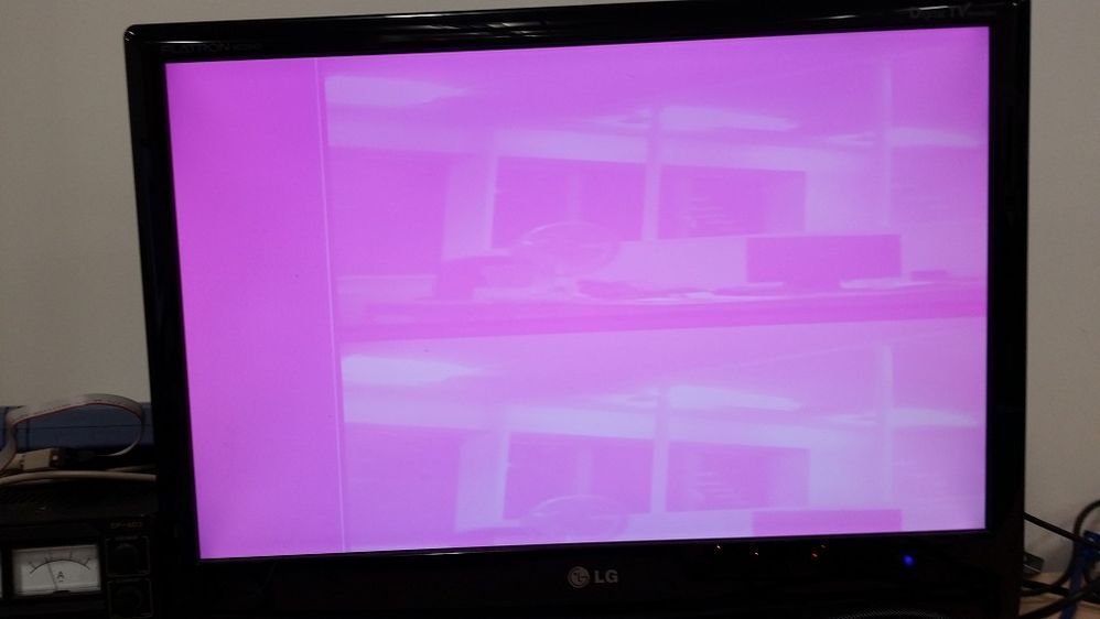

Hello
I'm trying to get the ADV7180 working with the Bluechip Technologies RM3 based on the quad core i.mx6.
I'm using Yocto with the Bluechip layer for the RM3.
I have connected:
P0-P7  on the ADV go to IPU1_CSI0_D_13-19 (I think)
LLC to MX6Q_PAD_CSI0_PIXCLK__IPU1_CSI0_PIXCLK
VS/FIELD to MX6Q_PAD_CSI0_VSYNC__IPU1_CSI0_VSYNC
HS to MX6Q_PAD_CSI0_MCLK__IPU1_CSI0_HSYNC
RESET to MX6Q_PAD_NANDF_CS2__GPIO_6_15
INTRQ to CAM_IRQ (not that I think this is used)
PWRDWN to MX6Q_PAD_CSI0_DATA_EN__GPIO_5_20
With adv7180.c as is the tvin unit test times out.
However if I set p->u.bt656.clock_curr = 27000000; as mentioned in another post on this forum I get the image below.
Anyone seen an image like this before?
I think it could be today with EAV SAV not being read? But I'm new to bt656 and I'm not sure how to check!

Turns out the problem was the 8bit bt.656 being connected to the lower 8 bits of the 10bits available. Had to physically move connection up by two bits. Now works fine. Thanks.

jamiew
Hi Igor
Thank you for your reply.
The output shown is from mxc_v4l2_tvin, however I haven't seen any options for "bt656 configuration". Where do I set that?
Thanks for the links too, I had already read the first two but will read through the third one now.
Jamie
