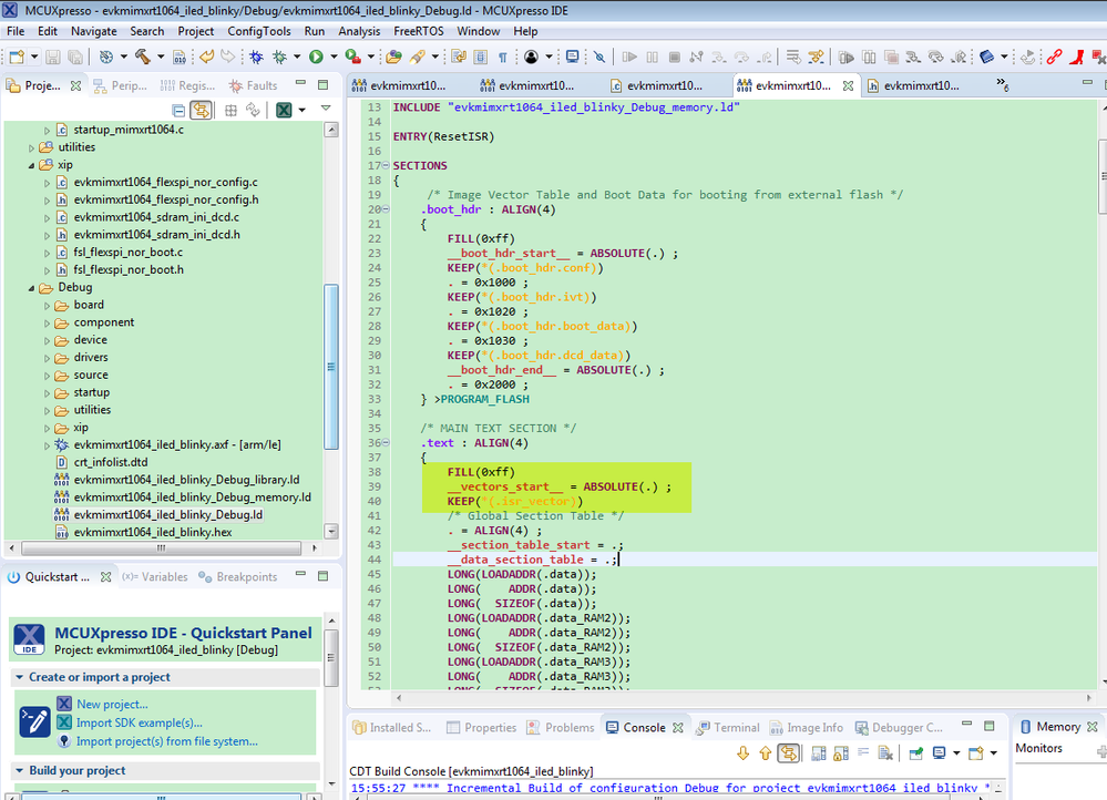

I am using the IMXRT 1064 EVK board. My application is at 0x70008400 address, (see linker attached debug.ld, debug_memory.ld). When i try to debug my code it results into hardfault (see attached file Debug.png). Earlier  i have used KDS with similar linker settings and it used to debug fine even if application start address is different from the flash base address. As we have shifted to new platform IMXRT with MCUXpresso the issue is observed.
When i jump to address 0x70008400 from my bootloader it is working and my application is running so i feel the linker settings are correct. But when i try to debug am getting hardfault. I am using PE Micro MULTILINK UNIVERSAL debugger.
Please let me know what could be the issue.

   If you want to change the app memory location, you can't modify the Flash address from 0X70000000 to 0x70008400, it's not correct.
  From 0X70000000, it will put the flexpi_nor config code, ivt, boot data, dcd data, these it used for the boot, from 0X70002000, it is your app area, so you can modify the address from 0x70002000 to your 0x70008400, 0x70000000 to 0x70001fff must can't be modified.
  So, if you want to modify, please modify the .isr_vector address to your designed app address:
Program address should still from 0X70000000.

  Do you mean you debug the app project at 0x70008400, but when you debug it, do you download the ivt, boot data, dcd data from 0x70000000, not just use the bootloader code? IVT should put in 0x70001000.
  About the application address from 0x70002000 to 0x70008400, I think you can insert a sector (size is 0x6400)before the isr_vector in the .ld file. In the IVT code, the IMAGE_ENTRY_ADDRESS should be the app adress, actually it is the ISR_VECTOR address.

Yes i debug the project which is at 0x70008400. There are no  ivt, boot data, dcd data from 0x70000000 when i debug the project at 0x70008400.
do i need these at 0x70000000? currently there is no code at 0x70000000 when i debug my app at 0x70008400.
Anuj
5,753 Views
kerryzhou
Hi Anuj,
   Yes, you need to add it.
   As you know, after the chip boot, it will configure the external flash, and read the IVT, then use the IVT enter the app code, so, if you lack the IVT, it will can't enter the app code and debug it in the XIP mode.
