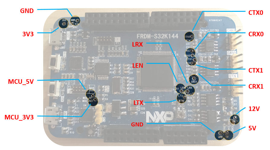

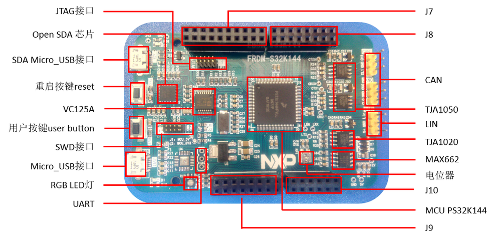

To accelerate S32K demand creation and support urgent evaluation requriement in Great China, we build one batch boards locally. These boards will only be given out to our potential opportunities for free. The boards are made by China local partner and verified by AE and FAE team. if you have any question on this kind of board, please go to China Auto CAS or Auto MCU marketing for support.
1. Board overview

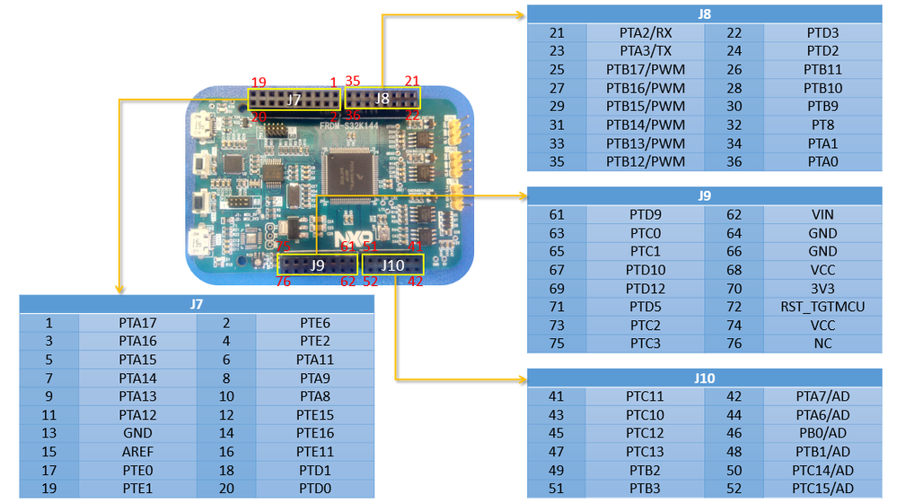

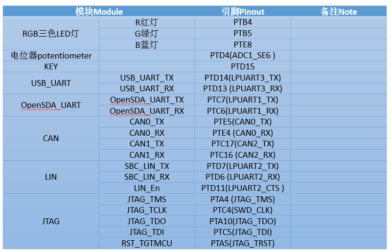

2. Pinout
3. Test point

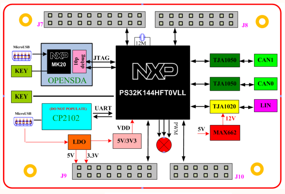

4. Block diagram
3. The main difference between NXP official S32K EVB and this FRDM-S32K144 board are OpenSDA firmware and CAN PHY

  • The CAN physical is different. This board used standalone CAN PHY but not CAN SBC. Please refer SCH file for debug.
