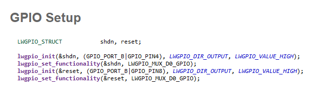

    1. We'll start with setting up the Temperature Task. The first thing to do is to set up the two GPIO lines that will drive the reset and the shut down inputs to the temperature sensor. Use the lwgpio_init() function to initialize the shutdown pin (which is connected to GPIO Port B, pin 4). This should be configured as an output with an initial value of 'high'. Do the same to initialize the reset line (which is connected to GPIO Port B, pin 8). This should also be an output with an initial value of 'high'. You may want to review the lab for session 5 that covered GPIO to remind yourself of how to do this.
    2. You will also need to set the functionality for these two pins using the lwgpio_set_functionality() function. Note that you'll need a LWGPIO_STRUCT for each to set the functionality.

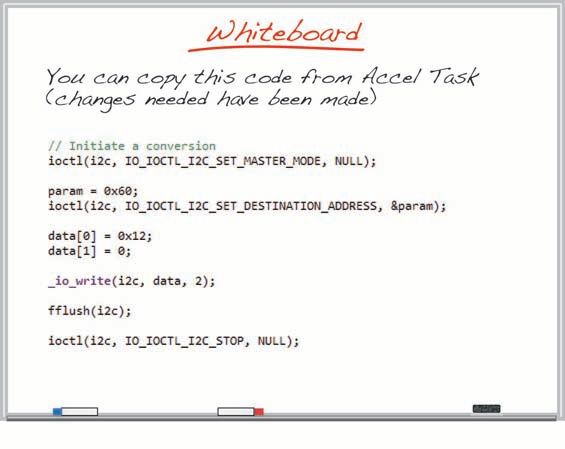

    4. The temperature sensor needs to be instructed to do a conversion, but before the Temp Task can send this message there is some set up to do. Inside the while(1) loop of the Temp Task you need to communicate with the temperature sensor to:
        • put the I2C bus in Master Mode
        • set the destination address
        • write a 2 byte message to the temperature sensor (containing 0x12, 0x0 to write a zero to register 0x12 to initiate the conversion)
        • flush the bus
        • then assert a Stop condition
          Fortunately we just finished doing all of this in the Accel Task in the lab for the previous session. Copy this section of code from the Accel Task and put it at the top of the while(1) loop of the Temp Task. The destination address of the temperature sensor is 0x60. Remember to declare the variable used for ioctl parameters, the data array, tracking the bytes read, and the result returned from the io_read() function.
    5. Keep the _time_delay() function already in this code but shorten the delay to 50 msec which will be enough time for a convertion of the temperature. This is all that is needed to allow the temp sensor to complete a conversion.

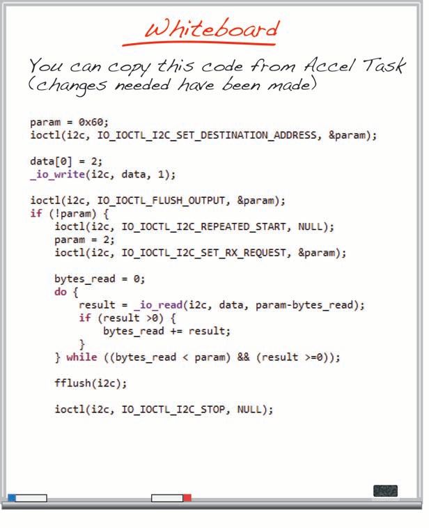

    6. Once the temperature conversion has been done you can now read the temperature value. Again we can borrow this code from Accel Task. You need to:
      • Set the destination address to 0x60
      • Write 0x02 to the I2C bus to indicate that you wish to read two bytes from the sensor.
      • Flush the output buffer with an ioctl() call using the IO_IOCTL_I2C_FLUSH_OUTPUT command
      • If the ACK bit was received after the previous write (ie the parameter returned from the ioctl call was not set) then use a Do loop to read the two bytes back from the bus.
      • Use an ioctl call to issue a stop using the IO_IOCTL_I2C_STOP.
      • Make all necessary declarations. The data array of uint8_t can be 4 bytes in size since we are reading shorter messages back from the temperature sensor.

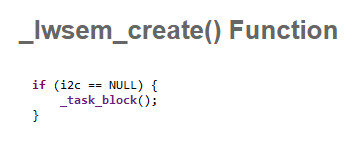

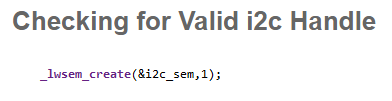

    1. We now are ready to get to the main part of our lab which is to use a semaphore to protect the access to the I2C bus. Declare a light weight semaphore of type LWSEM_STRUCT in main.c right after the declaration of the I2C file handle. Add this as an extern in main.h to keep the compiler happy.
    2. The semaphore needs to be created with the _lwsem_create() function and for the reasons that the I2C channel was opened in the Health Task, the semaphore should be created in the same area. Initialize the semaphore with a count of 1 to restrict access to a single task (ie a binary semaphore).

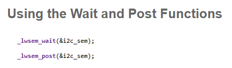

    3. The semaphore can now be used to safeguard against simultaneous access of the bus. Use the _lwsem_wait() function and the _lwsem_post() functions in the areas of the code that access the bus. The semaphore wait should be done before the first ioctl call over the bus and the post should be used after the stop condition has been asserted. Note that there are two places in the Accel Task where the I2C bus is accessed, first when the accelerometer is turned on, and second in the while(1) loop when the data is being read.

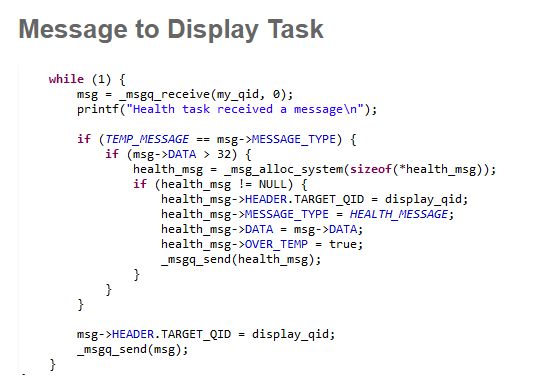

    1. The code is now set up such that the temperature read is sent to the Health Task but currently all the Health Task does in response is to print out the fact that it received a message. To make use of the temp data received the Health Task needs to be updated so it detects if there is an over temperature condition and react to it when that condition occurs. As well, in the event of an over temp condition, the Health Task should send a message to the Display Task to notify it of the situation. To facilitate this add a Boolean to the APPLICATION_MESSAGE data structure in main.h called 'OVER_TEMP'.
    2. In the while(1) loop of the Health Task add a check of the incoming messages to see if they are of type 'TEMP_MESSAGE' and check if the temperature received in this message is greater than a threshold temperature of say 32 C. Add the code to send a message to the Display Task in an over temperature situation. Note that a new message of type APPLICATION_MESSAGE will need to be declared at the top of the Health Task. When creating the new message the Target Queue ID ('->Header.TARGET_QID') and the message type ('->MESSAGE_TYPE') will have to be set. The message data ('->data') can be the received temperature and of course our new parameter to the APPLICATION_MESSAGE called OVER_TEMP should be set to true.

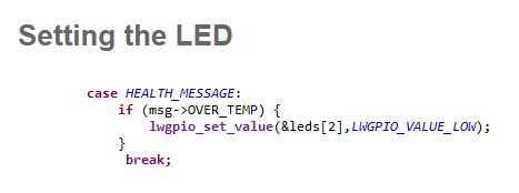

  1. The last thing to add is the visual indication of an over temp condition by turning on an LED. This is similar to what was done in the previous lab when motion was detected by the Theft Task. In the Display Task add a new case to the switch statement that processes incoming messages to handle a HEALTH_MESSAGE. If the OVER_TEMP bool in the message is set, LED 2 should be turned on.
