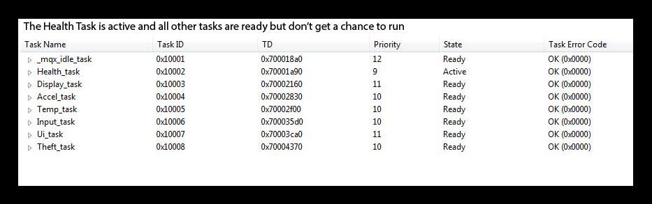

    2. Update the priority levels in the Task Template List to reflect your selected priorities. Remember that a lower number is actually a higher priority level and that it will unnecessarily use more memory if you leave gaps in your priority levels. Assign the highest priority tasks to level 9, medium to level 10, and low priority tasks to level 11.

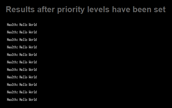

    3. Run your code and observe the output on the terminal. Pause the execution and observe the Ready Queue in TAD.

    1. With Round Robin Scheduling we saw that a schedule yield from the active task allowed the next task in the ready queue to run. That doesn't work though when you have tasks at different priorities and the only way a higher priority task will yield the CPU to a lower priority task is to enter a blocked state. So our use of a time delay before wasn't such a bad idea after all. Change the sched_yield call in the Health Task to a one second time delay and see what happens. You may have to put a break point on the time_delay in the Health Task in order to catch its printout.

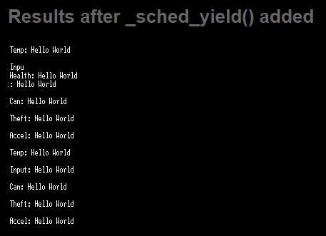

    2. We now have a means for the high and medium priority tasks to run so we need to extend this to allow the low priority tasks to run as well. Since we currently don't have a means of unblocking from any of the blocking calls other than a time delay we'll have to stick with that for now, but these will all eventually be replaced. Update all tasks now to use a one second time delay in lieu of the schedule yield. Now see what results you get.

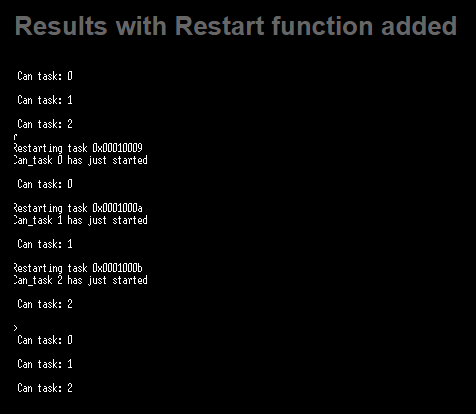

  5. Finally, add one more command to your UI to restart the CAN Tasks by entering an 'r'. In order to see when a task has started add a printf in the initialization section of the CAN Task code that indicates that the task has just started with the ID parameter passed to the CAN Task.
