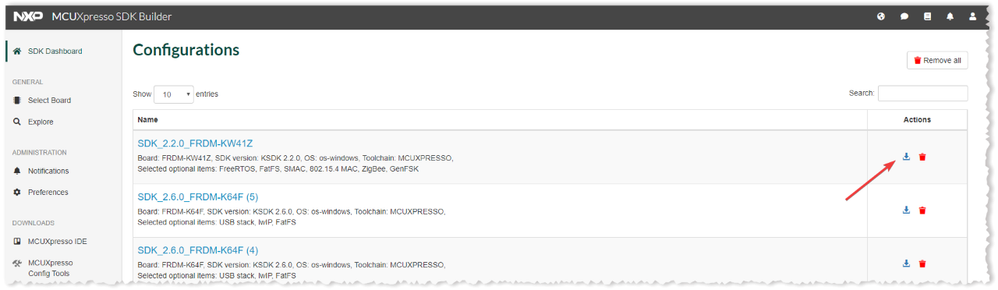

What is the “Configurations” page and how it is used?

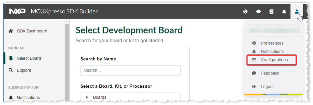

  • The Configurations page is currently located within MCUXpresso SDK Builder page under user icon at the top right corner.pastedImage_64.png
  • The Configurations page has primarily been used as an overview of a user’s configurations created within MCUXpresso SDK Builder.
  • The ability to download MEX configuration files was added later as an additional feature (aligned with MEX file configuration support within MCUXpresso Config Tools).

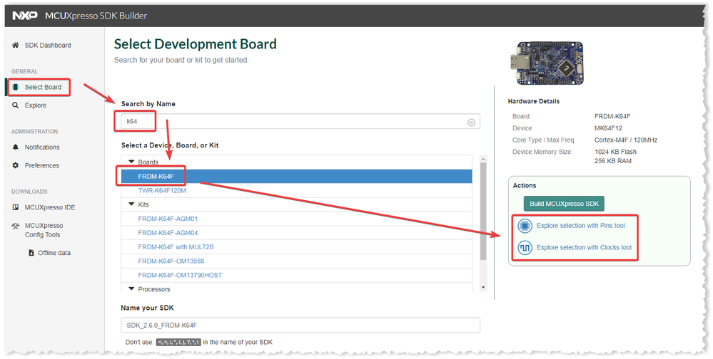

    • Downloading MEX file for MCUXpresso Config Tools - Temporary configuration option (user does not have SDK package already in user’s Dashboard yet)
      • Go on Select Board page
      • Search the HW platform you are looking for
      • Select the HW platform by clicking on it
      • After clicking at selected HW platform, the right side will populate with more options
      • Select the option to ‘Explore selection with Pins tool’ or ‘Explore selection with Clocks tool’
  • The selected MCUXpresso Config Tools application will load

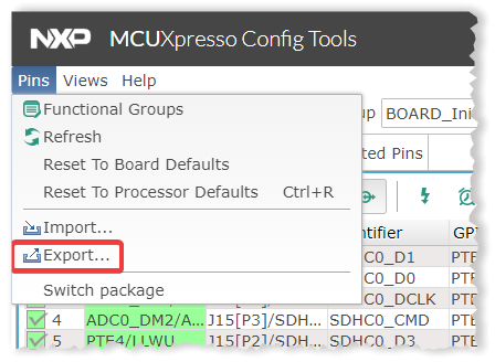

  • There you can make any changes (if needed) within your configuration selected.
  • From the left side top tools’ menu (Pins/Clocks), select “Export” option.

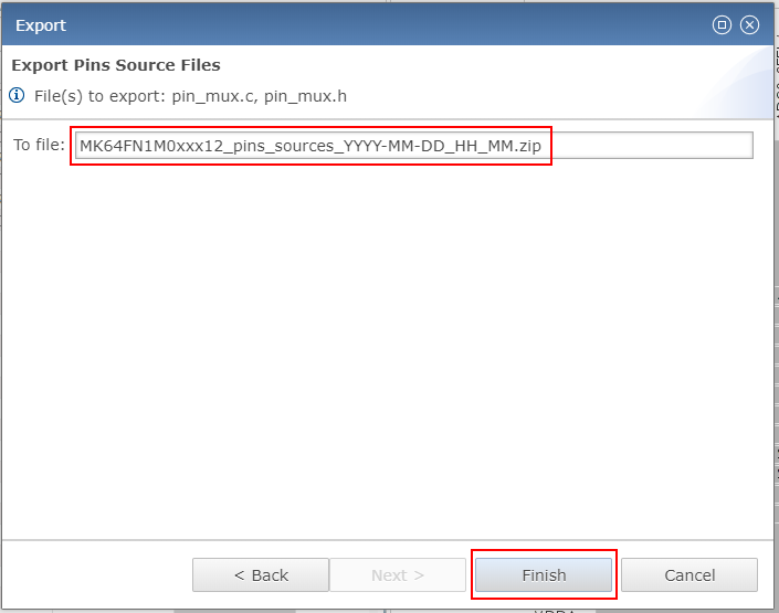

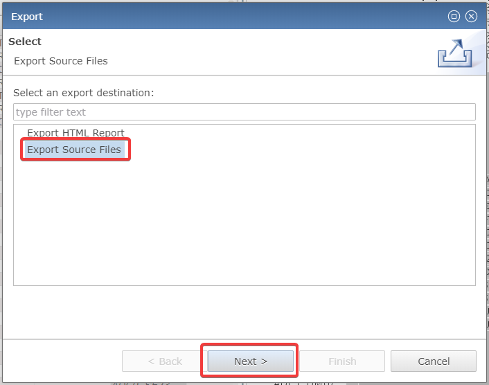

  • Select ‘Export Source Files’ option from the resulting dialog window, then click on the ‘Next’ button.
  • Here you can specify the name your configuration if needed and click ‘Finish’ button at the bottom.
  • The resulting archive will include your MEX configuration.pastedImage_70.png

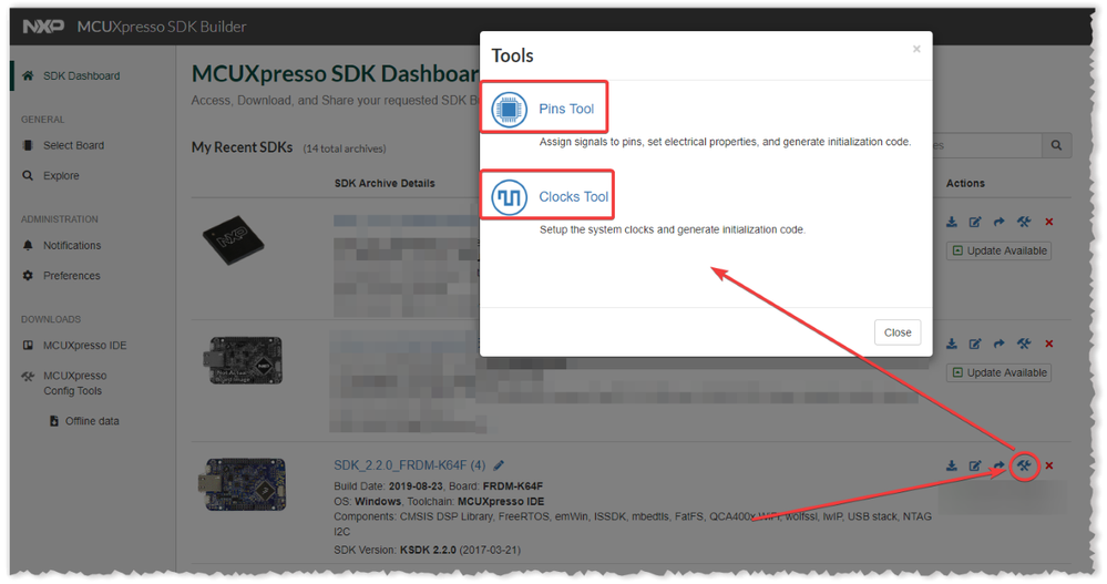

  • Downloading MEX file configuration for SDK package – (User has already a SDK Packages in User’s Dashboard)
    • Go to your Dashboard page
    • Look for the SDK package with a configuration you would like to download
    • Click on MCUXpresso Config Tools icon, a dialog with MCUXpresso Config Tools options appears. Select the desired option to launch one of the respective online applications.pastedImage_71.png

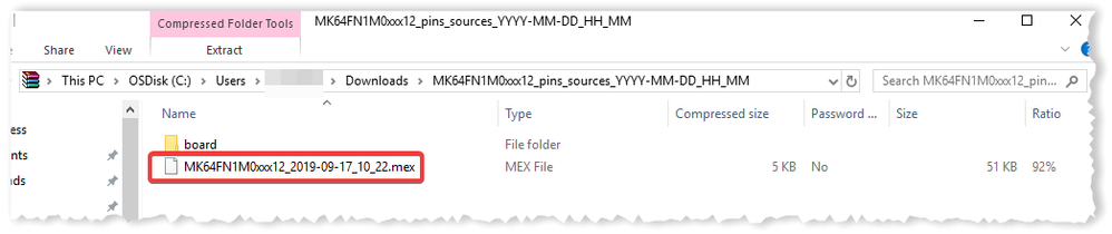

  • The resulting archive will include your MEX configuration.pastedImage_75.png
